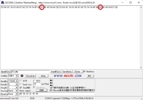

    So I decided to text the button first. Even though I am trying to implement the custom values, it keeps sending the default values in the output. Please check the images attached.
    I want the button to send ‘5’ when pressed, and ‘6’ when released, but it sends 1 and 2.

    1, The red box below needs to be set to hexadecimal, for example:  0005, 0006

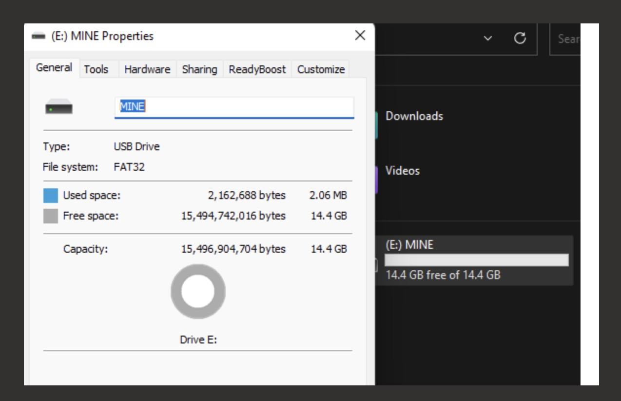

    But it Not working..
    Check the images..
    Also I switched the USB to host mode.. Inserted the USB drive and restart.. Nothing happens, it just comes to the home screen

    1, This firmware needs to change the name to stoneHMI.bin
    2, Then update the firmware again.
