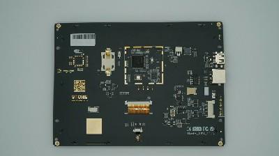

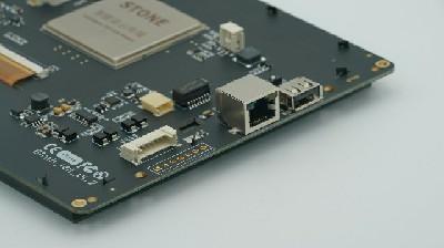

      I have also attached a few photos of our new version.

      The photos of our new version

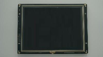

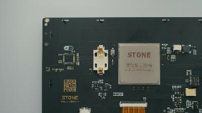

      Please check the attached “User Manual” and “Instruction Set Description”. “datasheet sheet: STWI070WT-01”. Our 7″ screen also works with Arduino. I have also attached a few photos of this model.
