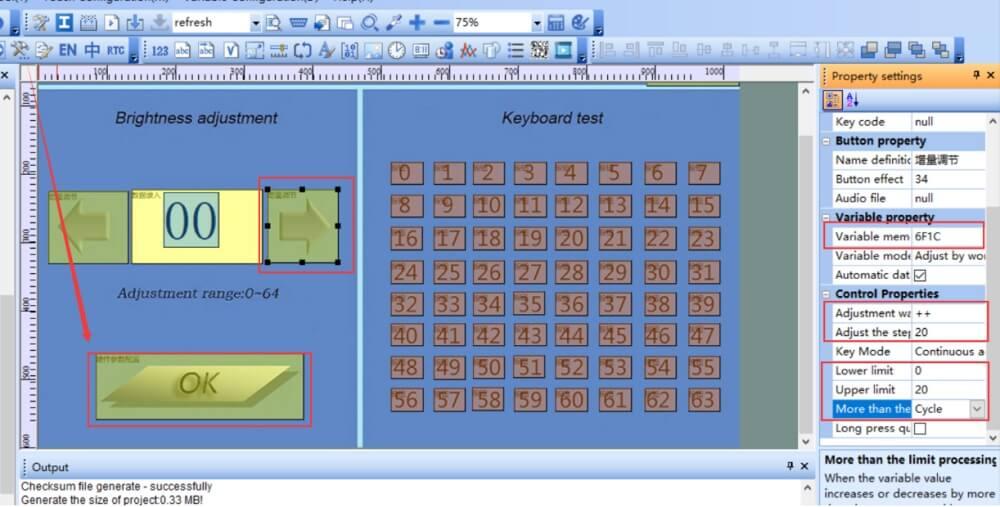

      I had some problems with the Stone Tool Box GUI software. How to activate or turn off the buzzer with the button?

      For your question, please follow the Settings in the picture:
      activate-or-disable-a-buzzer-with-a-button-in-stone-tool-box-gui-design-software
      Then, using the “Hardware parameter configuration” function, set the value of 6F1C to the 1C register (register 1C controls the hardware Settings).
      You can find more details in Chapter 3.8.4 of the development guide
      Please let me know if you have any other questions.
