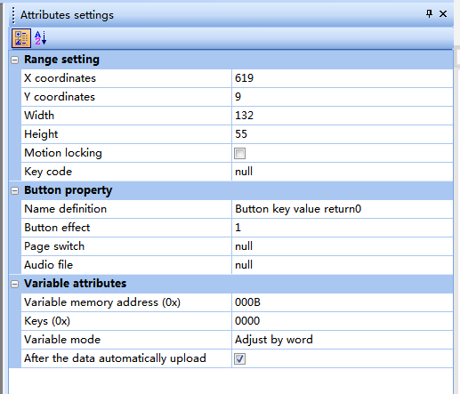

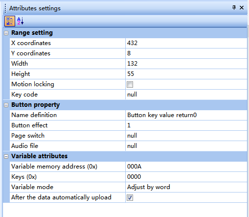

GUI design:
Start button setting
Stop button setting

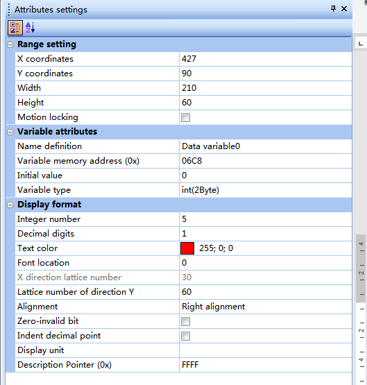

Digital display box

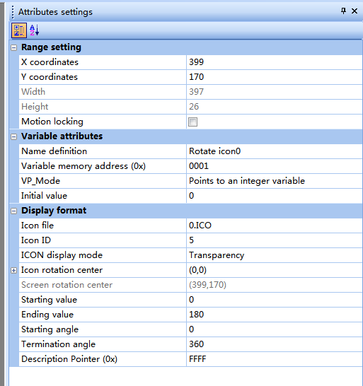

Rotating pointer configuration

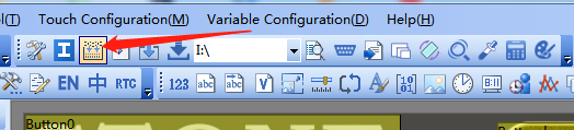

Compile to see if there are any errors after setting up the display controls
Status output box at the bottom, no errors or warnings

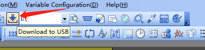

Connect the USB socket on the back of the touch screen, click on download
Download completed
